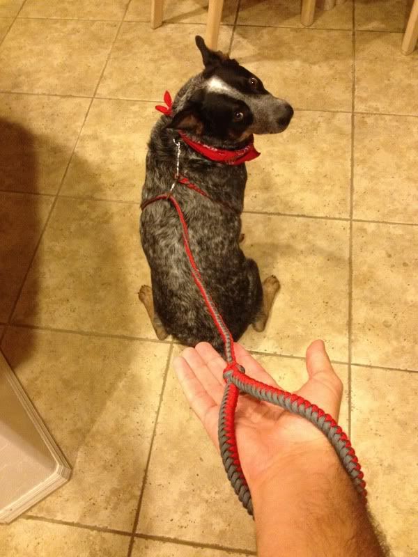

So my ACD doesnt like other dogs, and being that he's a pin head he can back out of your standard collar. Not to mention some days hes just in the mood to PULL.
I put him on a martingale collar, but wanted to go a step further. Harness seem like a hassle, so it was recomended I use a leash as such:
Loops through itself and tightens around the ribs, not the neck when the dog pulls, or can be used like a regular leash. I was doing this with my nylon leash but it didnt easily loosen itself back up when the dog stopped pulling, so out came the cord.
I wanted to do a snake knot, but I knew it would take toooo long and use way too much cord. I needed a leash that was 60" plus the loop, in order to effectively fit around the dog and still be more than traffic lead length.
So, i was going to do a snake weave loop, then continue with some other braid. In my research I came across some videos on youtube showing this exact thing. Snake knot loop, entering a double lanyard knot, then using those 4 strands to do a 4 strand round braid, then tying it off on itself at the end.
The dog is gray and red:
So I went with gray and red cord.
Now I have an "escape proof" setup that is also good for training him to not pull!

I based it off of stuff I read and i did a few tests.
Something somewhere said you need roughly 1' of cord for 1" of snake weave, I think this means you need 6" of each side/color. I kept 16' of each cord for the thing, and edned up cutting a good 3' or 4' off.
I then just did 12" of 4 strand round braid, unraveled it, and figured out how much cord it took. I weave mine super tight which doesnt seem necessary, and hurt smy hands, but it came out to be that 12" of the braid required a TOTAL of 18" of cord per side. So, basically the 2 starting strands to make 1.5' of 4 strand round braid were 3' long each.
So, i figured i needed 5' of leash, which meant 7.5' of cord per side.
I did 7.5' (one side of the round braid) + 16' (snake knot in the middle) + 7.5' (other side of round braid) and added a little for safety on each end.
I actually almost ran short, so I would maybe do 9', 16', 9' and you should have plenty.
I just started the snake knot 8' into one side, and left that side loose, did the 16" snake knot, folded it in half, tied the 4 strand lanyard knot using the 4 strands.....and then used the out coming 4 strands todo the braid. Easy Peasy!
